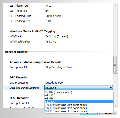

            Why it is impossible to select "Decoding Down Sampling" for DSD conversion to WAV as in dBpoweramp Music Converter:

            Why 96 kHz but not 88.2 kHz is recommended?

              I do not understand, you image shows you able to select the option.
              96Khz is a common samplerate which players can play, 88 is not.
                Why it is impossible to select "Decoding Down Sampling" for DSD conversion to WAV "on the fly" in Asset UPnP Configuration as in dBpoweramp Configuration?
