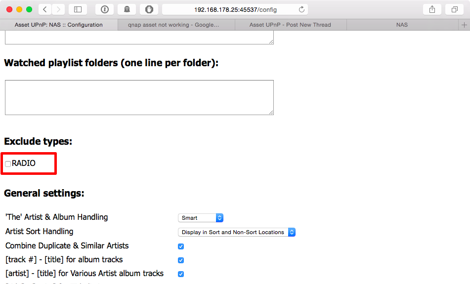

    What's really strange, though, is that the main config page only shows "RADIO" as filetype, as seen in the following screenshot:
    Also the transcode settings area on the bottom of the main config page only has a single dropdown for "RADIO".

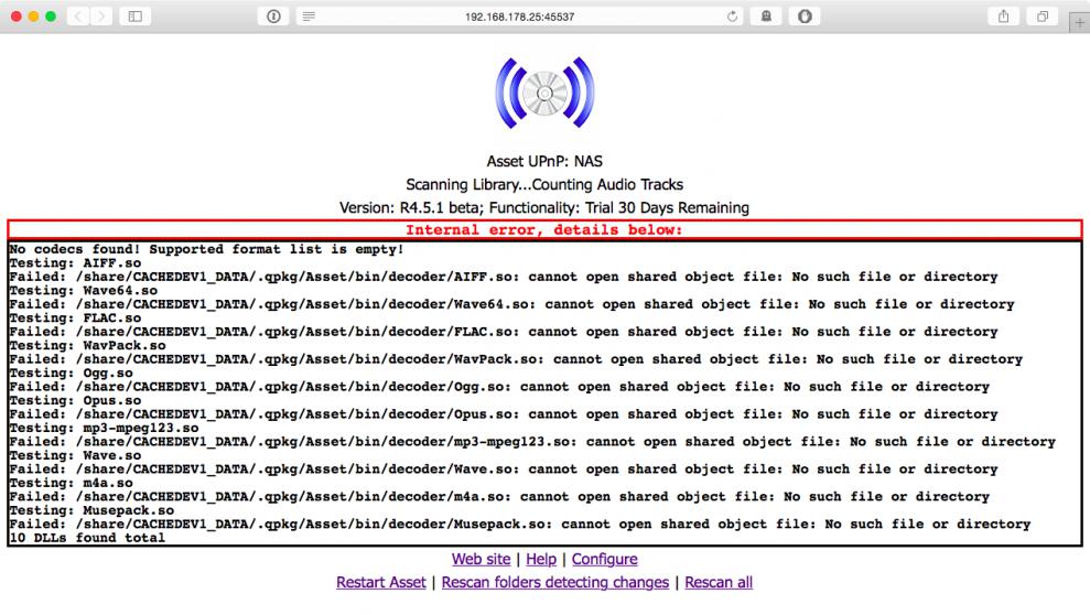

            • Gummibando
              • Jun 2015
              Re: Can't get Asset to work on a QNAP TS-231+
              Peter, your hunch was correct.
              The decoder modules are not loaded.

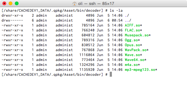

              But they are indeed located at the required path.
                • 1645
                Thanks, this is most interesting.
                Can you please run:
                ldd *.so
                .. in the decoders directory, and post the output?
                The error message seems pretty nonsensical but I'm guessing that it means that the .so loader is unable to find some other .so files that our ones depend on, hence "no such file or directory"...
