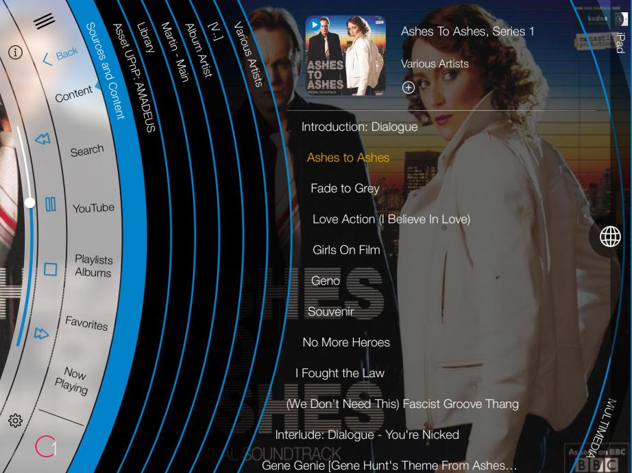

                      That's what I thought at first too. However, the problem occurs with other players as well. For example, see the attached screenshot from the C5+ app which in this case is set to use the iPad as the player (see top right corner) instead of M1 CliC. The music plays on the iPad itself. You can see the track listing still excludes the artist:

                      To answer your question, the M1 CliC does not display Artist for non-compilations but then again, it's not meant to!

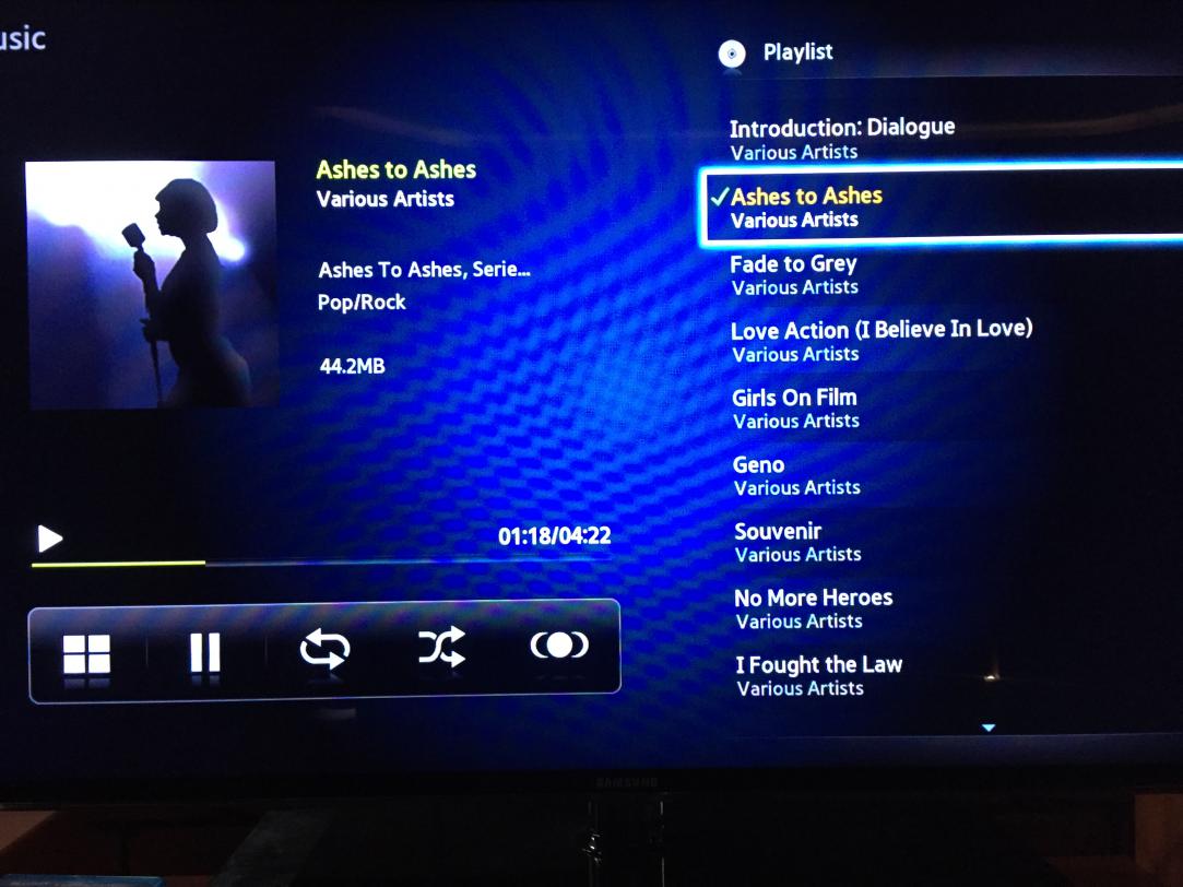

                        And just to make double sure, I have also tried another UPnP player - my Samsung TV set, using the Asset UPnP server, also displays only the track Title and no track Artist:
                        So, with three players not displaying the track Artist, I think the problem must lie elsewhere!

                              I understand your logic here, but having worked in the IT/Music environment for many years, I have learnt one very important rule, never assume anything.
                              I have just tested this on 3 DLNA compatible devices in my system. A Pioneer HD TV, an OPPO BDP-83SE Blu-ray Disc Player and a Samsung BD-C6900 Blu-ray Disc Player. All my Compilations have the Compilation tag = 1 and Album Artist tag = Various Artist.
                              The Samsung is as you describe for your Samsung TV. I get Title, but no Artist in the track listing. Also the Album Artist appears to override the Artist, so, all tracks appear to have Artist = Various Artist.
                              When I browse the same compilation album on the Pioneer and OPPO devices, I get Artist - Title correctly displayed in the track listing, so the Asset UPnP advanced setting, [artist] - [title] for Various Artist album tracks, appears to be working well for these devices.
                              I conclude (and yes, this is an assumption) that for many devices, the software/firmware is very poorly written in the handling of Album Artist, Artist and Compilation albums. I also have an iPod Classic, which due to the poorly written firmware, only uses Artist tags and completely ignores the Album Artist tag, which presents it's own very annoying issues.
