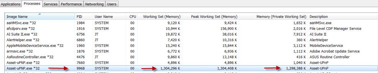

              Spoon, R5 hasn't helped. It's been a couple of hours since I re-configured all the settings, and now Asset-uPNP.exe, located in C:\Program Files (x86)\Illustrate\dBpoweramp, is now sitting at 1,287,004 KB of Memory (Private Working Set). (and growing as I write this)
              I'm not doing anything with Asset at the moment. No Control Point is playing anything at this time.
              There are 2 Asset-uPNP.exe active.
              In the time it took to write this, it has gone from 1287 MB to over 1400 MB. I am killing it. Any advice how to proceed ?
Name:	Asset memory issue.jpg
