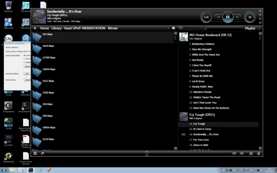

        If I may ask one more question: Since I have added the customized filed "Bitrate", is there any way to aggregate the values shown (refer to the picture attached of how it looks in Kinsky) let's say to max. 5 different values? I've seen that you have implemented a similar function for the rating (with the stars such as "*** & higher") but I could not find anything in the setup window of how you did it. Have you hard-coded this function or can I use it in other fields such as Bitrate, perhaps even frequency, etc. too? As usual, Thank you for your feedback.
        Further, I've downloaded release 4 (still using 3) - do I have to update or shall I leave a running system? Kindly advise.
        Best regards, Dirk

          Re: Did I kill Asset Server?
          It is not possible, sorry.
