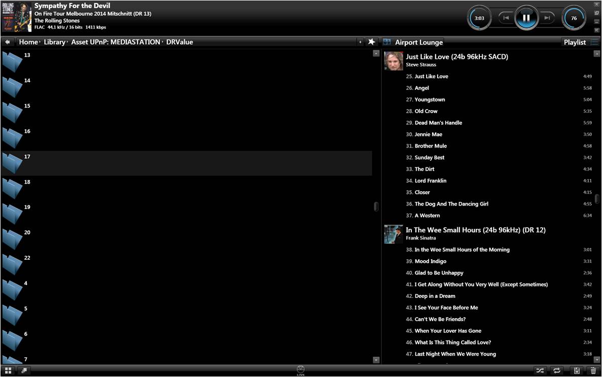

    I created a separate tag entry for the DR-Value of each track and for the album. The system automatically recognizes these values and it works fine. It is regardless whether I add these values using Foobar or add them manually. But unfortunately the page that show the DR-Values (Home/Library/Asset UPNP: Mediastation [my PC]/DRValue) looks a bit suspicious as the values starts with 10,11,12, etc. up to 22, followed by 4 (my lowest value from a ripped CD), 5, 6, etc. up to 9. I have tried to find a solution here in the forum but was not successful to find a solution for my issue on my own.

    It will be because they are alphabetic sorted, you would have to name as '04' to have '4' appear before '11'

      I forgot to post the image which hopefully explains a bit better my current issue. On the left-hand you see that after 22 (that is my highest DR value), 4, 5, 6, etc. are going to follow. I know that a leading zero such as 04, 05, etc. would perhaps solve my problem but none of the DR Tools are writing a leading zero to single values. Is there any option to avoid in doing this "hand-made" ?

        Thank you for your prompt response. I've just added another note that I would like to avoid such "tailored" values. Is there any other possibility that might work only to this customized column? Nevertheless there might be other users that may need a similar structure, but for different purposes. Honestly said, going through some 18.000 files and try to correct them is too much work to do.... - Anything that could help to avoid would be greatly appreciated. Thank you.

          Sorry there is no other possibility.
