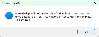

            This is asinine. I have tried 250 CD's. The best I can do is get three discs to get to the configuration stage
Name:	AccurateRip will not key.png
            I repeat that this drive was used with this version of CD Ripper with these CD's. What the hell is going on?
              • 43949
              Re: AccurateRip - AYFKM? 50+ discs and still no "Key Disc"?
              Your sample offset +16 does not match the +6 of the 800 or so people who have this drive, your drive perhaps has a problem.
