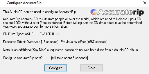

    I'm embarking on ripping ~1,000 CD's and want to get AccurateRip to work correctly.
    My problem is that I believe the drive offset listed in AR's database is incorrect. I have a ASUS - BW-16D1H-U, and the database shows an offset value of +6, but this is based on only 2 submissions. My drive appears to have an offset of +667. The reason I believe the database is wrong is that I've already obtained a second drive of the same make, and both show +667, not just on one disc but on 5 different ones I've tried (not from the same box).
    When I insert a key disk, I get the following message:

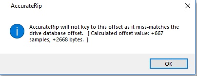

    After clicking "Configure AccurateRip", I get the message:
    So it seems that as long as my drive's offset doesn't match the (presumably incorrect) database value, I cannot use AccurateRip.
    Is there a way to override the database value so that I can start relying on AR?

    Re: How to override drive offset in database
    It is 22 submissions, all with +6, however they have a drive BW-16D1X-U which is +667, it is not inconceivable that they have used this drives firmware for the other drive by mistake. We can mark the drive as a 'bad' drive and purge it from the database, but first step is to see if there is a later firmware.

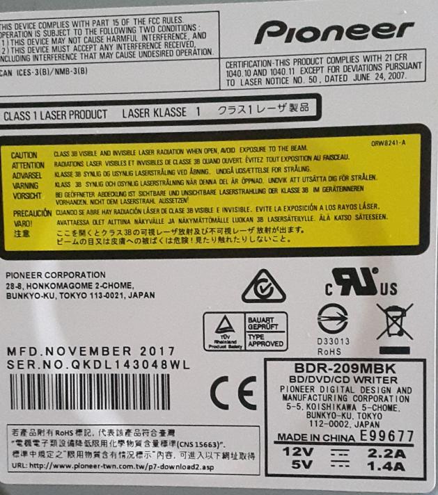

          I just bought the ASUS - BW-16D1H-U yesterday and got the same +667 offset as well.
          After some googling it seems to have been being sold with different drives. 1 with BDXL support and 1 without. The one without seems to be a LG drive and the one with it is a Pioneer.
          I decided to disassembly mine to take a closer look at the drive within and found a Pioneer BDR-209MBK with a BDXL sticker on the front.
          Took a picture of the sticker on the drive:
          Hopefully this can help correct the database, as I do think this one have a +667 offset as the other Pioneer 209's does.
            • 45160
            Good detective work, basically there are 2 different drives with the same model number...great
