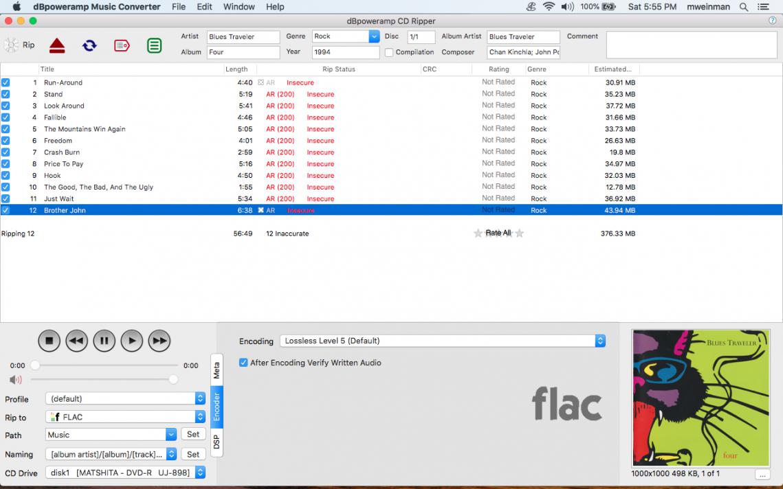

    Hello, I'm a new user and I'm confused. Just found this and am planning to rip my CD library finally. One of the main reasons is the significant error correction that is possible and the C2 pointers are a big part of it. I've followed the setup instructions, the drive and offset are recognized and am getting weird results. I've tried it on multiple discs (Blues Traveler - 4, A Tribe Called Quest - Natural Ingredients, Pink Floyd - Animals, Led Zeppelin - II, Luscious Jackson - Natural Ingredients, Michael Hedges - Taproot) and it happens to all of them. When the C2 pointers are on the result is "insecure" which seems due to not re-ripping thousands of frames eg:
    Drive & Settings
    Ripping with drive 'disk1 [MATSHITA - DVD-R UJ-898]', Drive offset: 102, Overread Lead-in/out: No
    AccurateRip: Active, Using C2: Yes, Cache: 4 KB, FUA Cache Invalidate: No
    Pass 1 Drive Speed: 40, Pass 2 Drive Speed: Max
    Ultra:: Vary Drive Speed: No, Min Passes: 2, Max Passes: 4, Finish After Clean Passes: 2
    Bad Sector Re-rip:: Drive Speed: Max, Maximum Re-reads: 75
    Encoder: FLAC -compression-level-5 -verify
    Extraction Log
    Track 1: Ripped LBA 32 to 21035 (4:40) in 2:34. Filename: /Users/mweinman/Music/Blues Traveler/Four/01 Blues Traveler - Run-Around.flac
    Insecure [Pass 1, Ultra 1 to 2, Re-Rip 4220 Frames]
    ** Aborted: Have to ReRip 4220 Frames, Re-Rip Limit Set to 100 Frames
    Track 2: Ripped LBA 21035 to 44975 (5:19) in 2:35. Filename: /Users/mweinman/Music/Blues Traveler/Four/02 Blues Traveler - Stand.flac
    AccurateRip: Inaccurate (confidence 200) Insecure [Pass 1, Ultra 1 to 2, Re-Rip 4841 Frames]
    ** Aborted: Have to ReRip 4841 Frames, Re-Rip Limit Set to 100 Frames

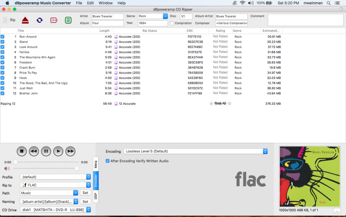

    But when the C2 pointers are off the result is "Accurate" eg:[/B]
    Drive & Settings
    AccurateRip: Active, Using C2: No, Cache: 4 KB, FUA Cache Invalidate: No
    Extraction Log
    Track 1: Ripped LBA 32 to 21035 (4:40) in 0:51. Filename: /Users/mweinman/Music/Blues Traveler/Four/01 Blues Traveler - Run-Around.flac
    AccurateRip: Accurate (confidence 200) [Pass 1]
    CRC32: FEF7E110 AccurateRip CRC: A7E4E4CB (CRCv2) [DiscID: 012-00197549-00eb3042-a10d510c-1]
    AccurateRip Verified Confidence 200 [CRCv2 a7e4e4cb]
    AccurateRip Verified Confidence 154 [CRCv2 79fe86f9], Using Pressing Offset +41
    AccurateRip Verified Confidence 113 [CRCv2 7a89a488], Using Pressing Offset +37
    AccurateRip Verified Confidence 54 [CRCv2 8dab76d4], Using Pressing Offset -191
    Track 2: Ripped LBA 21035 to 44975 (5:19) in 0:51. Filename: /Users/mweinman/Music/Blues Traveler/Four/02 Blues Traveler - Stand.flac
    CRC32: 952D7E3B AccurateRip CRC: D2B039D5 (CRCv2) [DiscID: 012-00197549-00eb3042-a10d510c-2]
    AccurateRip Verified Confidence 200 [CRCv2 d2b039d5]
    AccurateRip Verified Confidence 150 [CRCv2 8d3a0ad3], Using Pressing Offset +41
    AccurateRip Verified Confidence 113 [CRCv2 fe7b8757], Using Pressing Offset +37
    AccurateRip Verified Confidence 55 [CRCv2 b29718a6], Using Pressing Offset -191
    What is going on, am I doing something wrong, what are the rips loosing because they are not dealing with the frame errors?

    Re: New trial user - w/C2 pointers = inaccurate vs w/o C2 pointers = success
    Hey Matt,
    some drives pretend that they can handle C2 pointers but they can't. This leads to a behaviour like you've seen. Turn C2 poibters off and forget about it. AccurateRip can give you bitperfect rips even without C2 pointers.
  3. #3
    dBpoweramp Guru
    Join Date
    Nov 2007
    Location
    Florida, USA
    5,608
    Quote Originally Posted by Dat Ei View Post
    Hey Matt,
    Agree, I have seen the same behavior re: C2 pointers (only 1 of the 5 drives I have used actually used C2 properly; despite the fact that all 5 drives "report" that they use C2. As @Dat Ei notes, with AccurateRip matching, C2 is irrelevant.
