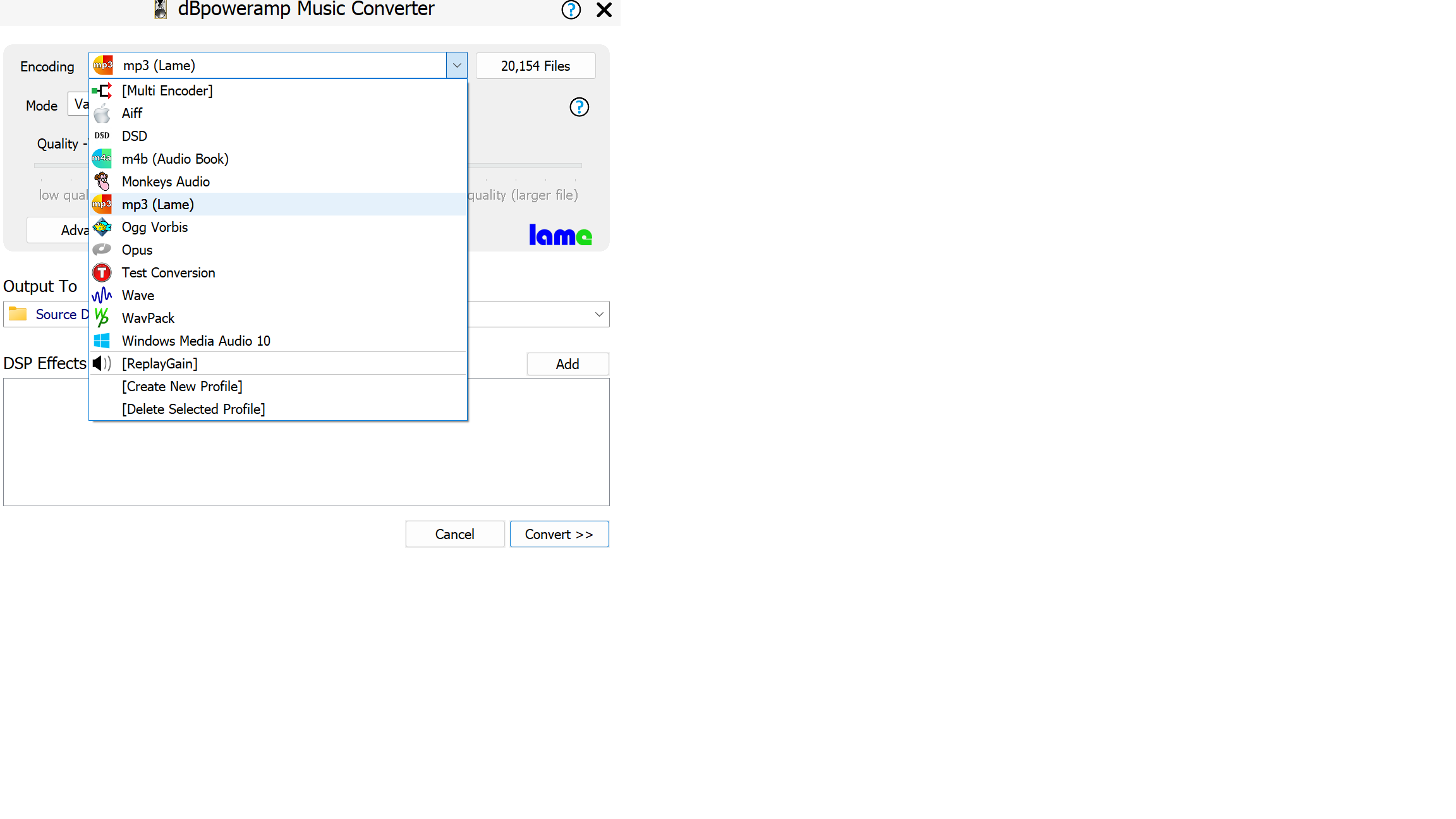

          Where is FLAC???
            • 43915
            Re: ALAC to FLAC
            Try reinstalling dBpoweramp, after uninstalling it.

              Re: ALAC to FLAC
              Originally posted by aspiecoder
              Where is FLAC???
              [ATTACH=CONFIG]3508[/ATTACH]
              odd. It should be one of the codecs listed there in the dropdown.

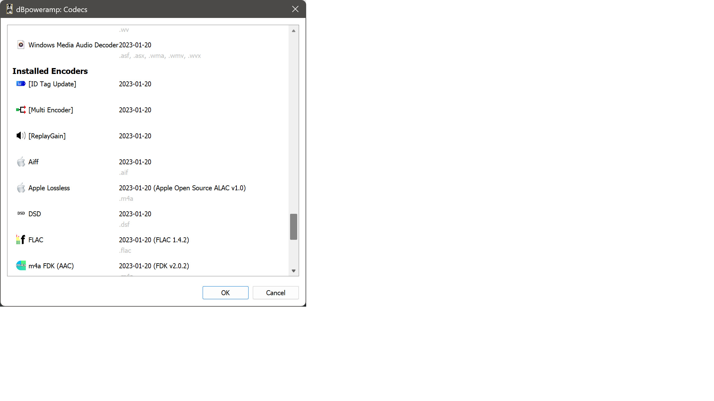

                No luck .... It looks like the encoder is installed.

                  Re: ALAC to FLAC
                  dBpoweramp Control Centre >> Advanced options >> Hidden Encoders
                    dBpoweramp Guru
                    • 5743
                    Re: ALAC to FLAC
                    Interesting. I've never noticed this option. Slightly more specifics:
                    dBpoweramp Control Centre >> (Configuration) Advanced Settings >> dBpoweramp Reference heading >>> Hidden Encoders

                      Re: ALAC to FLAC
                      Thank you for your help everyone. I got it working by removing all the files and registry stuff; then reinstalled.
