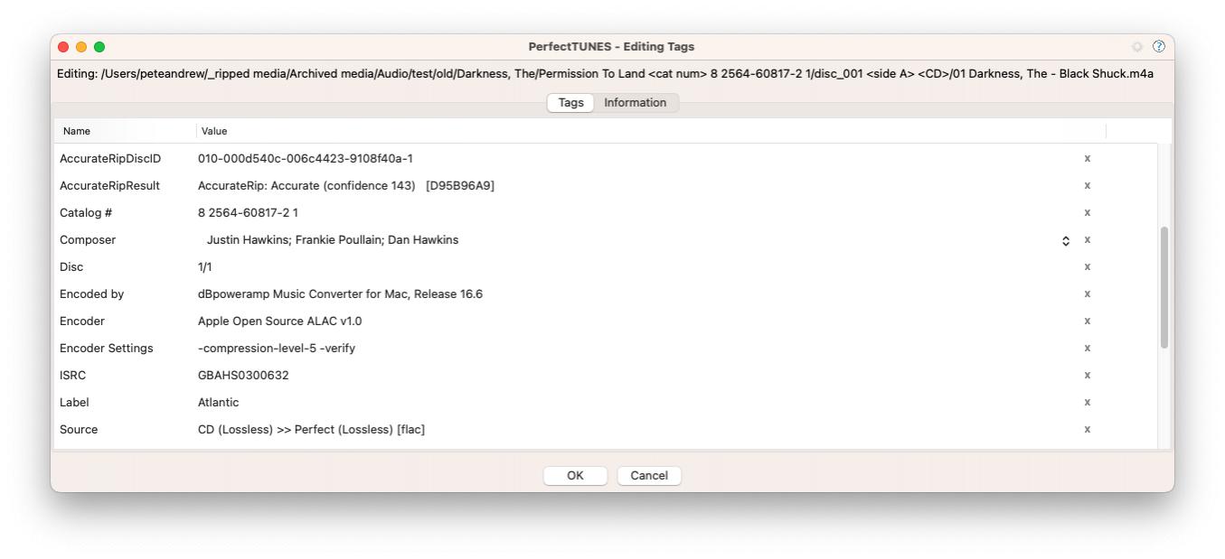

    If I started with Apple Lossless (which I believe I did - but I have no good reasons why I might have then transcoded them to M4A, which is a me problem), there should be _no_ quality loss by dropping them to 512, correct?
    Regarding the tools I used (and if it was/was-not done via dBPoweramp), this is the only information I could find Screenshot 2023-01-30 at 9.37.00 AM.jpg

    AAC is a lossy codec, converting to 128, 512, or any value results in quality loss, how much depends on bitrate.
