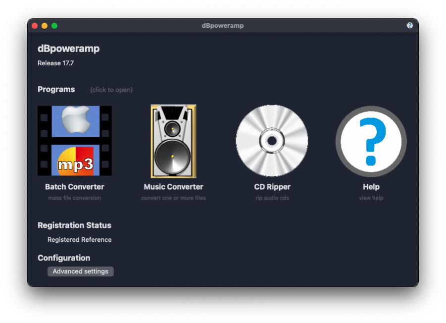

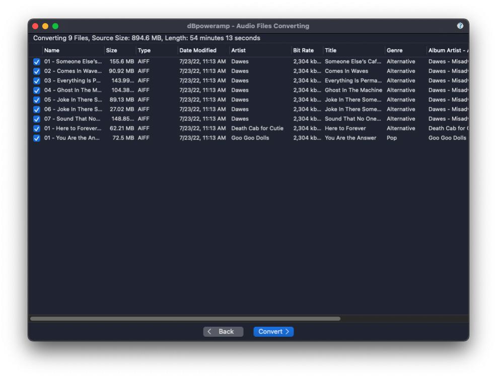

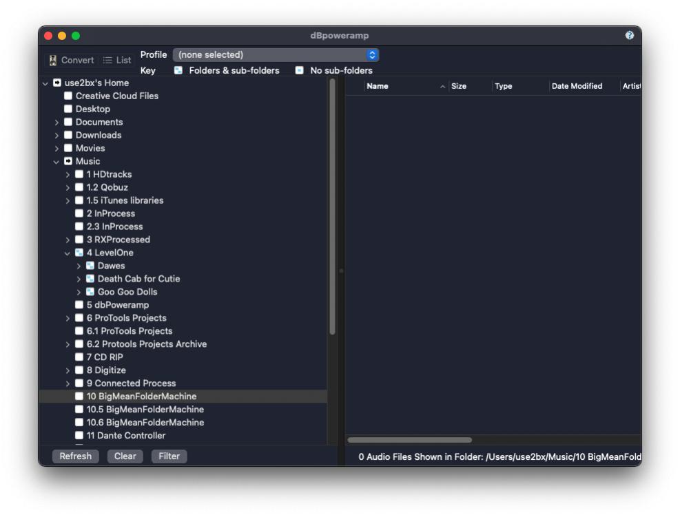

    I've attached screenshots to show the steps.
    1. app selector
    2. batch selector window showing'4 LevelOne' folder containing folders of files to be processed
    3. after clicking the 'list' function showing 9 files to be processed

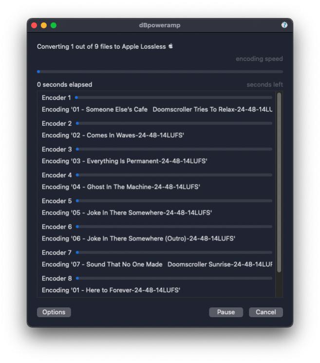

    4. next window ready to process
    5. list of the files and status showing 0 seconds elapsed, which hangs for an extended period.

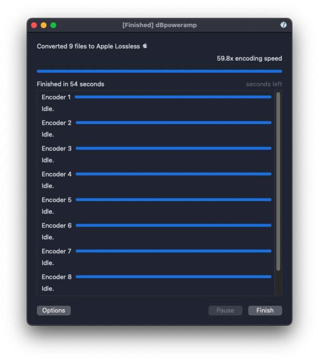

    I'll add another post with the final window when complete.

    Re: Batch Converter Hang on initial startup
    Final app window showing processing complete.
