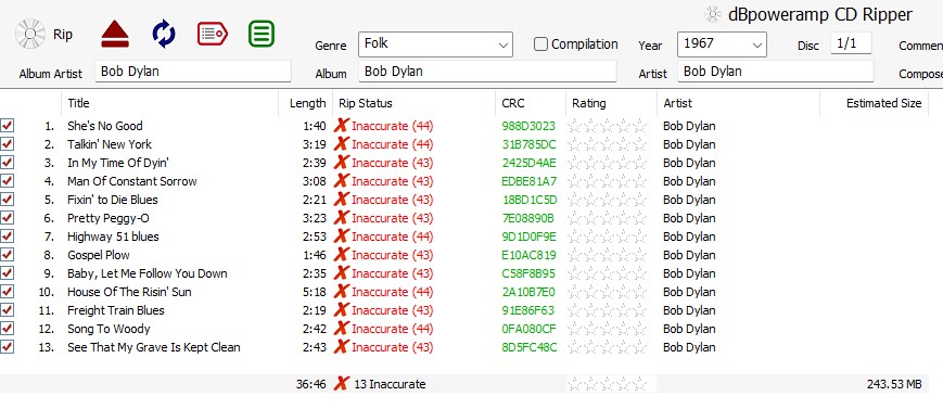

    Just got a new Verbatim KIAB, which shows as a Pioneer BDR-UD04 in dBpoweramp. On first use it did the Accuraterip configuration and set the appropriate offset of +667.
    However, when I tested the drive with multiple CD, every track returned a rip status as inaccurate.
    I have another drive and tested the same CD, all ripped flawlessly.
    I am on 17.7 of dBpoweramp, and did try reverting to an older version, but that also had the same issues.
    Is there something I could do to prove the drive is at error?

    I did the rip several times (tried different cable too)and the CRC values were always the same -
    Used CUERipper, the log suggests that all tracks were accurately ripped - eg "Accurately ripped (confidence 62) [7057017E]"

    Drive seems to be okay with CUERipper, but not with dbpoweramp!
