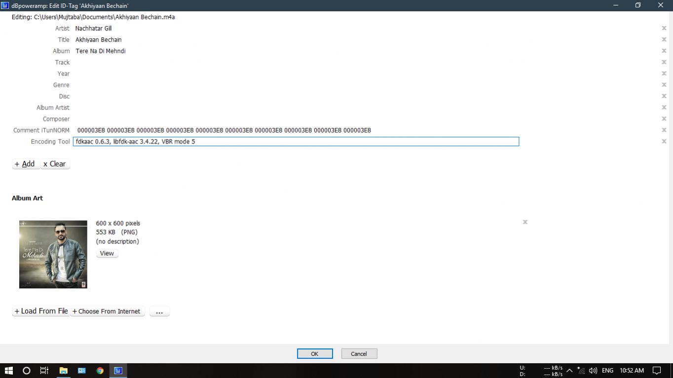

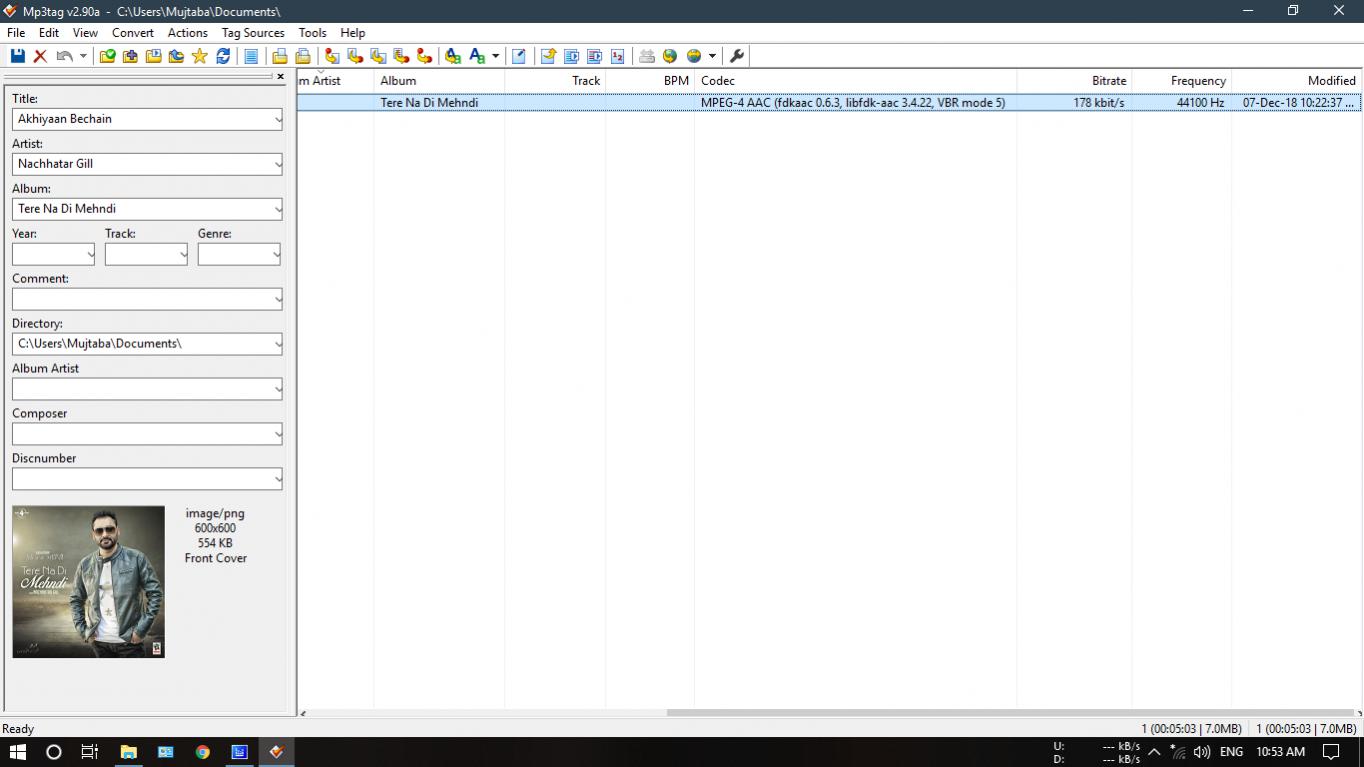

    When editing in dbpoweramp it shows a value at the bottom of the tags which is Encoding Tool (the string defined above except MPEG-4 AAC) Screenshot (1).jpg whereas in mp3tag, it shows the full string defined above Screenshot (2).jpg
    Please guide me to remove that Encoding tool tag in dbpoweramp

    It is only possible to remove these tags after the files have been converted, we do not write that tag, the FDK aac encoder does. To remove them install the [ID Tag Update] utility codec from here:
    https://www.dbpoweramp.com/codec-central-utility.htm
    Use batch converter to select your root folder and set the encoder to '[ID Tag Update]' then on the settings page set to delete the Encoding Tool tag.

    It seem that the encoding library is embedded into the file and not a editable tag.
