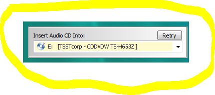

    No problem with until today. When I launch the service, it seems it's running but nothing appears on the screen except "insert Audio CD into" Menu (see attachment). The main menu dpesn't appear on the screen but it seems the service is running.

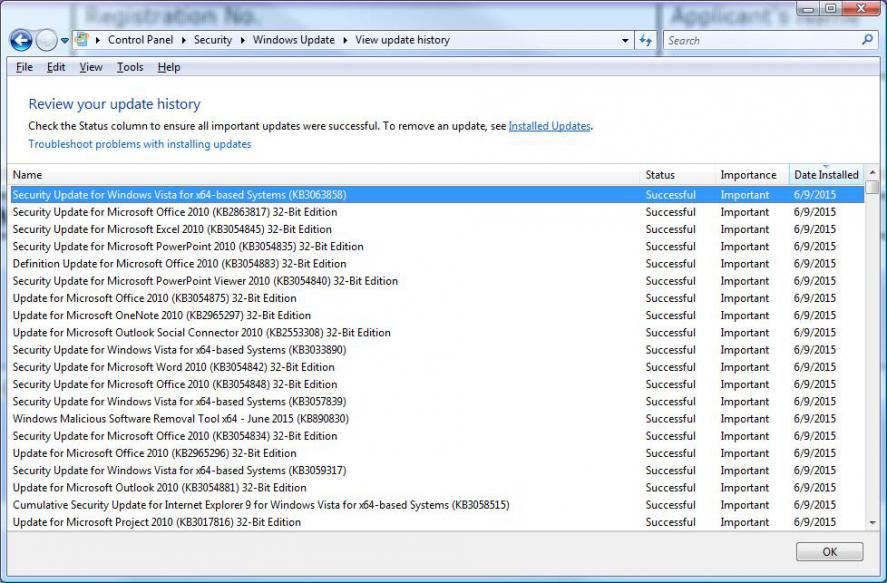

    No, Avira. My Vista is Home Premium SP2 64-Bit. It seems like I lost dbpoweramp functionality after the Vista security updates on Tuesday.

    Seems the common denominator is the Vista Updates.
