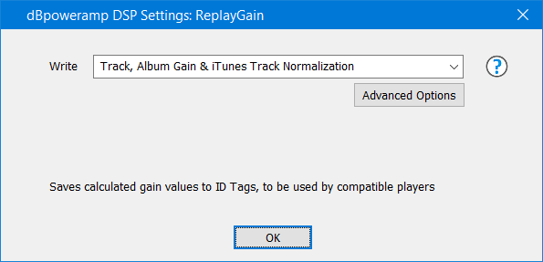

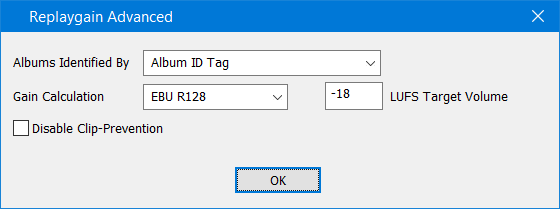

    i am using the default replay settings, pls could you guide if is ok. pls find attached screen shot. replay gain (1).pngreplay gain (2).png
    what does one use if not using iTunes ?? could you suggest a setting, please.

    Those settings are fine, even if not using iTunes.
