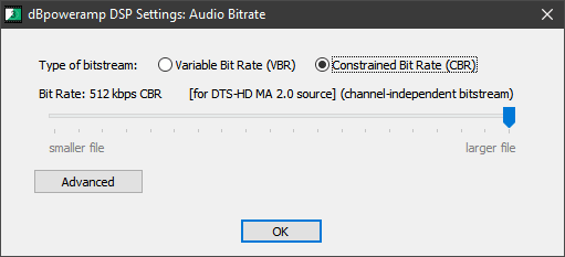

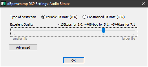

3 Attachment(s)
Re: Custom DSP Settings
[CODE]\DSPs\Audio Bitrate[/CODE]
Whoops, I messed up - the vbr switch does not work - what does work is the [CODE]q:a [/CODE] [number 1-5] tag. Correct version below. I also added the options for AAC HE and AAC HEv2 although you might want to test a bit before committing to those settings. It certainly seems to work with CBR IF you resample to 24khz, but without resampling to 24Khz you'll get a 96Khz output from standard 48KHz input, so either I'm missing some settings or the current build included isn't fully implemented. Same with Cutoff frequency (you wouldn't want to touch that anyway under most circumstance)
Cheers!

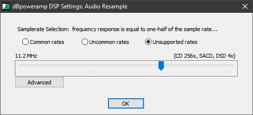

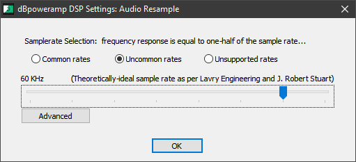

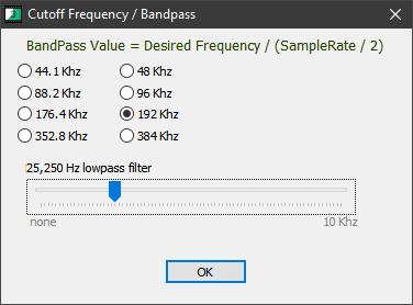

5 Attachment(s)
[CODE]\DSPs\Audio Resample[/CODE]
This is for the Audio resample DSP. Note that the -cutoff function does not seem to be implemented right now
[ATTACH=CONFIG]2879[/ATTACH]
[ATTACH=CONFIG]2882[/ATTACH]
[ATTACH=CONFIG]2883[/ATTACH]
[ATTACH=CONFIG]2880[/ATTACH]
[ATTACH=CONFIG]2881[/ATTACH]

17,750 Hz lowpass filter
-cutoff=0.804988662131519
17,500 Hz lowpass filter
-cutoff=0.793650793650794
17,250 Hz lowpass filter
-cutoff=0.782312925170068
17,000 Hz lowpass filter
-cutoff=0.770975056689342
16,750 Hz lowpass filter
-cutoff=0.759637188208617
16,500 Hz lowpass filter
-cutoff=0.748299319727891
16,250 Hz lowpass filter
-cutoff=0.736961451247165
16,000 Hz lowpass filter
-cutoff=0.72562358276644
15,750 Hz lowpass filter
-cutoff=0.714285714285714
15,500 Hz lowpass filter
-cutoff=0.702947845804989
15,250 Hz lowpass filter
-cutoff=0.691609977324263
15,000 Hz lowpass filter
-cutoff=0.680272108843537
14,750 Hz lowpass filter
-cutoff=0.668934240362812
14,500 Hz lowpass filter
-cutoff=0.657596371882086
14,250 Hz lowpass filter
-cutoff=0.646258503401361
14,000 Hz lowpass filter
-cutoff=0.634920634920635
13,750 Hz lowpass filter
-cutoff=0.623582766439909
13,500 Hz lowpass filter
-cutoff=0.612244897959184
13,250 Hz lowpass filter
-cutoff=0.600907029478458
13,000 Hz lowpass filter
-cutoff=0.589569160997732
12,750 Hz lowpass filter
-cutoff=0.578231292517007
12,500 Hz lowpass filter
-cutoff=0.566893424036281
12,250 Hz lowpass filter
-cutoff=0.555555555555556
12,000 Hz lowpass filter
-cutoff=0.54421768707483
11,750 Hz lowpass filter
-cutoff=0.532879818594104
11,500 Hz lowpass filter
-cutoff=0.521541950113379
11,250 Hz lowpass filter
-cutoff=0.510204081632653
11,000 Hz lowpass filter
-cutoff=0.498866213151927
10,750 Hz lowpass filter
-cutoff=0.487528344671202
10,500 Hz lowpass filter
-cutoff=0.476190476190476
10,250 Hz lowpass filter
-cutoff=0.464852607709751
10,000 Hz lowpass filter
-cutoff=0.453514739229025
[/sliderend]
72
18
48 Khz
1
No Passband (Chebyshev)
-cheby=1
23,750 Hz lowpass filter
-cutoff=0.989583333333333
23,500 Hz lowpass filter
-cutoff=0.979166666666667
23,250 Hz lowpass filter
-cutoff=0.96875
23,000 Hz lowpass filter
-cutoff=0.958333333333333
22,750 Hz lowpass filter
-cutoff=0.947916666666667
22,500 Hz lowpass filter
-cutoff=0.9375
22,250 Hz lowpass filter
-cutoff=0.927083333333333
22,000 Hz lowpass filter
-cutoff=0.916666666666667
21,750 Hz lowpass filter
-cutoff=0.90625
21,500 Hz lowpass filter
-cutoff=0.895833333333333
21,250 Hz lowpass filter
-cutoff=0.885416666666667
21,000 Hz lowpass filter
-cutoff=0.875
20,750 Hz lowpass filter
-cutoff=0.864583333333333
20,500 Hz lowpass filter
-cutoff=0.854166666666667
20,250 Hz lowpass filter
-cutoff=0.84375
20,000 Hz lowpass filter
-cutoff=0.833333333333333
19,750 Hz lowpass filter
-cutoff=0.822916666666667
19,500 Hz lowpass filter
-cutoff=0.8125
19,250 Hz lowpass filter
-cutoff=0.802083333333333
19,000 Hz lowpass filter
-cutoff=0.791666666666667
18,750 Hz lowpass filter
-cutoff=0.78125
18,500 Hz lowpass filter
-cutoff=0.770833333333333
18,250 Hz lowpass filter
-cutoff=0.760416666666667
18,000 Hz lowpass filter
-cutoff=0.75
-cutoff=0.739583333333333
-cutoff=0.729166666666667
-cutoff=0.71875
-cutoff=0.708333333333333
-cutoff=0.697916666666667
-cutoff=0.6875
-cutoff=0.677083333333333
-cutoff=0.666666666666667
-cutoff=0.65625
-cutoff=0.645833333333333
-cutoff=0.635416666666667
-cutoff=0.625
-cutoff=0.614583333333333
-cutoff=0.604166666666667
-cutoff=0.59375
-cutoff=0.583333333333333
-cutoff=0.572916666666667
-cutoff=0.5625
-cutoff=0.552083333333333
-cutoff=0.541666666666667
-cutoff=0.53125
-cutoff=0.520833333333333
-cutoff=0.510416666666667
-cutoff=0.5
-cutoff=0.489583333333333
-cutoff=0.479166666666667
-cutoff=0.46875
-cutoff=0.458333333333333
-cutoff=0.447916666666667
-cutoff=0.4375
-cutoff=0.427083333333333
-cutoff=0.416666666666667

-cutoff=0.255208333333333
-cutoff=0.25
-cutoff=0.244791666666667
-cutoff=0.239583333333333
-cutoff=0.234375
-cutoff=0.229166666666667
-cutoff=0.223958333333333
-cutoff=0.21875
-cutoff=0.213541666666667
-cutoff=0.208333333333333
[/sliderend]
10
42
176.4 Khz
1
-cheby=1
30,000 Hz lowpass filter
-cutoff=0.340136054421769
29,750 Hz lowpass filter
-cutoff=0.337301587301587
29,500 Hz lowpass filter
-cutoff=0.334467120181406
29,250 Hz lowpass filter
-cutoff=0.331632653061224
29,000 Hz lowpass filter
-cutoff=0.328798185941043
28,750 Hz lowpass filter
-cutoff=0.325963718820862
28,500 Hz lowpass filter
-cutoff=0.32312925170068
28,250 Hz lowpass filter
-cutoff=0.320294784580499
28,000 Hz lowpass filter
-cutoff=0.317460317460317
27,750 Hz lowpass filter
-cutoff=0.314625850340136
27,500 Hz lowpass filter
-cutoff=0.311791383219955
27,250 Hz lowpass filter
-cutoff=0.308956916099773
27,000 Hz lowpass filter
-cutoff=0.306122448979592
26,750 Hz lowpass filter
-cutoff=0.30328798185941
26,500 Hz lowpass filter
-cutoff=0.300453514739229
26,250 Hz lowpass filter
-cutoff=0.297619047619048
26,000 Hz lowpass filter
-cutoff=0.294784580498866
25,750 Hz lowpass filter
-cutoff=0.291950113378685
25,500 Hz lowpass filter
-cutoff=0.289115646258503
25,250 Hz lowpass filter
-cutoff=0.286281179138322
25,000 Hz lowpass filter
-cutoff=0.283446712018141
24,750 Hz lowpass filter
-cutoff=0.280612244897959
24,500 Hz lowpass filter
-cutoff=0.277777777777778
24,250 Hz lowpass filter
-cutoff=0.274943310657596
24,000 Hz lowpass filter
-cutoff=0.272108843537415
-cutoff=0.269274376417234
-cutoff=0.266439909297052
-cutoff=0.263605442176871
-cutoff=0.260770975056689
-cutoff=0.257936507936508
-cutoff=0.255102040816327
-cutoff=0.252267573696145
-cutoff=0.249433106575964
-cutoff=0.246598639455782
-cutoff=0.243764172335601
-cutoff=0.24092970521542
-cutoff=0.238095238095238
-cutoff=0.235260770975057
-cutoff=0.232426303854875
-cutoff=0.229591836734694
-cutoff=0.226757369614512
-cutoff=0.223922902494331
-cutoff=0.22108843537415
-cutoff=0.218253968253968
-cutoff=0.215419501133787
-cutoff=0.212585034013605
-cutoff=0.209750566893424
-cutoff=0.206916099773243
-cutoff=0.204081632653061
-cutoff=0.20124716553288
-cutoff=0.198412698412698
-cutoff=0.195578231292517
-cutoff=0.192743764172336
-cutoff=0.189909297052154
-cutoff=0.187074829931973
-cutoff=0.184240362811791
-cutoff=0.18140589569161
-cutoff=0.178571428571429
-cutoff=0.175736961451247
-cutoff=0.172902494331066
-cutoff=0.170068027210884
-cutoff=0.167233560090703
-cutoff=0.164399092970522
-cutoff=0.16156462585034
-cutoff=0.158730158730159
-cutoff=0.155895691609977
-cutoff=0.153061224489796
-cutoff=0.150226757369615
-cutoff=0.147392290249433
-cutoff=0.144557823129252
-cutoff=0.14172335600907
-cutoff=0.138888888888889
-cutoff=0.136054421768707
-cutoff=0.133219954648526
-cutoff=0.130385487528345
-cutoff=0.127551020408163
-cutoff=0.124716553287982
-cutoff=0.1218820861678
-cutoff=0.119047619047619
-cutoff=0.116213151927438
-cutoff=0.113378684807256
[/sliderend]
72
42
192 Khz
1
-cheby=1
-cutoff=0.3125
-cutoff=0.309895833333333
-cutoff=0.307291666666667
-cutoff=0.3046875
-cutoff=0.302083333333333
-cutoff=0.299479166666667
-cutoff=0.296875
-cutoff=0.294270833333333
-cutoff=0.291666666666667
-cutoff=0.2890625
-cutoff=0.286458333333333
-cutoff=0.283854166666667
-cutoff=0.28125
-cutoff=0.278645833333333
-cutoff=0.276041666666667
-cutoff=0.2734375
-cutoff=0.270833333333333
-cutoff=0.268229166666667
-cutoff=0.265625
-cutoff=0.263020833333333
-cutoff=0.260416666666667
-cutoff=0.2578125
-cutoff=0.252604166666667
-cutoff=0.25
-cutoff=0.247395833333333
-cutoff=0.2421875
-cutoff=0.236979166666667
-cutoff=0.234375
-cutoff=0.231770833333333
-cutoff=0.2265625
-cutoff=0.221354166666667
-cutoff=0.21875
-cutoff=0.216145833333333
-cutoff=0.2109375
-cutoff=0.205729166666667
-cutoff=0.203125
-cutoff=0.200520833333333
-cutoff=0.197916666666667
-cutoff=0.1953125
-cutoff=0.192708333333333
-cutoff=0.190104166666667
-cutoff=0.1875
-cutoff=0.184895833333333
-cutoff=0.182291666666667
-cutoff=0.1796875
-cutoff=0.177083333333333
-cutoff=0.174479166666667
-cutoff=0.171875
-cutoff=0.169270833333333
-cutoff=0.166666666666667
-cutoff=0.1640625
-cutoff=0.161458333333333
-cutoff=0.158854166666667
-cutoff=0.15625
-cutoff=0.153645833333333
-cutoff=0.151041666666667
-cutoff=0.1484375
-cutoff=0.145833333333333
-cutoff=0.143229166666667
-cutoff=0.140625
-cutoff=0.138020833333333
-cutoff=0.135416666666667
-cutoff=0.1328125
-cutoff=0.130208333333333
-cutoff=0.127604166666667
-cutoff=0.125
-cutoff=0.122395833333333
-cutoff=0.119791666666667
-cutoff=0.1171875
-cutoff=0.114583333333333
-cutoff=0.111979166666667
-cutoff=0.109375
-cutoff=0.106770833333333
-cutoff=0.104166666666667
[/sliderend]
10
54
352.8 Khz
1
-cheby=1
-cutoff=0.168650793650794
-cutoff=0.165816326530612
-cutoff=0.162981859410431
-cutoff=0.160147392290249
-cutoff=0.157312925170068
-cutoff=0.154478458049887
-cutoff=0.151643990929705
-cutoff=0.148809523809524
-cutoff=0.145975056689342
-cutoff=0.143140589569161
-cutoff=0.14030612244898
-cutoff=0.137471655328798
-cutoff=0.134637188208617
-cutoff=0.131802721088435
-cutoff=0.128968253968254
-cutoff=0.126133786848073
-cutoff=0.123299319727891
-cutoff=0.12046485260771
-cutoff=0.117630385487528
-cutoff=0.114795918367347
-cutoff=0.111961451247166
-cutoff=0.110544217687075
-cutoff=0.109126984126984
-cutoff=0.107709750566893
-cutoff=0.106292517006803
-cutoff=0.104875283446712
-cutoff=0.103458049886621
-cutoff=0.102040816326531
-cutoff=0.10062358276644
-cutoff=0.0992063492063492
-cutoff=0.0977891156462585
-cutoff=0.0963718820861678
-cutoff=0.0949546485260771
-cutoff=0.0935374149659864
-cutoff=0.0921201814058957
-cutoff=0.090702947845805
-cutoff=0.0892857142857143
-cutoff=0.0878684807256236
-cutoff=0.0864512471655329
-cheby=1
-cutoff=0.15625
-cutoff=0.154947916666667
-cutoff=0.15234375
-cutoff=0.149739583333333
-cutoff=0.1484375
-cutoff=0.147135416666667
-cutoff=0.14453125
-cutoff=0.141927083333333
-cutoff=0.140625
-cutoff=0.139322916666667
-cutoff=0.13671875
-cutoff=0.134114583333333
-cutoff=0.1328125
-cutoff=0.131510416666667
-cutoff=0.12890625
-cutoff=0.126302083333333
-cutoff=0.125
-cutoff=0.123697916666667
-cutoff=0.12109375
-cutoff=0.118489583333333
-cutoff=0.1171875
-cutoff=0.115885416666667
-cutoff=0.11328125
-cutoff=0.110677083333333
-cutoff=0.109375
-cutoff=0.108072916666667
-cutoff=0.10546875
-cutoff=0.102864583333333
-cutoff=0.1015625
-cutoff=0.100260416666667
-cutoff=0.0989583333333333
-cutoff=0.09765625
-cutoff=0.0963541666666667
-cutoff=0.0950520833333333
-cutoff=0.09375
-cutoff=0.0924479166666667
-cutoff=0.0911458333333333
-cutoff=0.08984375
-cutoff=0.0885416666666667
-cutoff=0.0872395833333333
-cutoff=0.0859375
-cutoff=0.0846354166666667
-cutoff=0.0833333333333333
-cutoff=0.08203125
-cutoff=0.0807291666666667
-cutoff=0.0794270833333333
-cutoff=0.078125
-cutoff=0.0768229166666667
-cutoff=0.0755208333333333
-cutoff=0.07421875
-cutoff=0.0729166666666667
-cutoff=0.0716145833333333
-cutoff=0.0703125
-cutoff=0.0690104166666667
-cutoff=0.0677083333333333
-cutoff=0.06640625
-cutoff=0.0651041666666667
-cutoff=0.0638020833333333
-cutoff=0.0625
-cutoff=0.0611979166666667
-cutoff=0.0598958333333333
-cutoff=0.05859375
-cutoff=0.0572916666666667
-cutoff=0.0559895833333333
-cutoff=0.0546875
-cutoff=0.0533854166666667
-cutoff=0.0520833333333333
